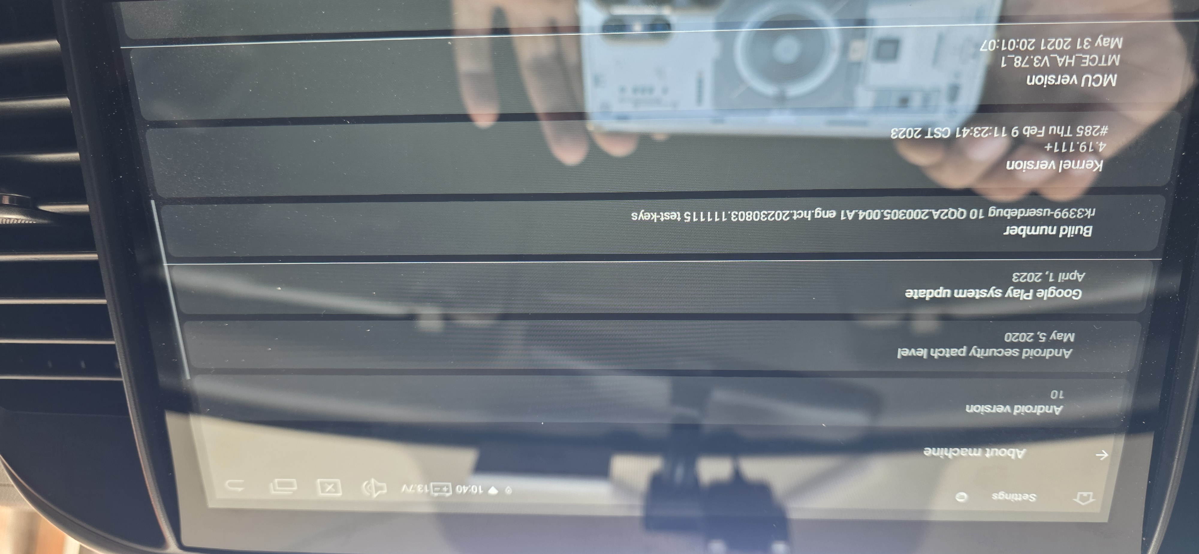

  • @Support Dasaita
    Hi,
    I downloaded and have tried installing this firmware update a couple of times now.  I get the below message each time that I try to install.  It starts off looking like it is going to install correctly, then it ends up going to the below screen.
    Your help would be greatly appreciated.
  • @Jason Ferguson
    Please delete the file on the USB drive and the laptop.
    Please try this again,thanks:
    https://www.dropbox.com/scl/fi/sy068zz4tgokutkfhuwkt/update.zip?rlkey=uuhukuun3882rz4cyqxsgs9k6&dl=0
