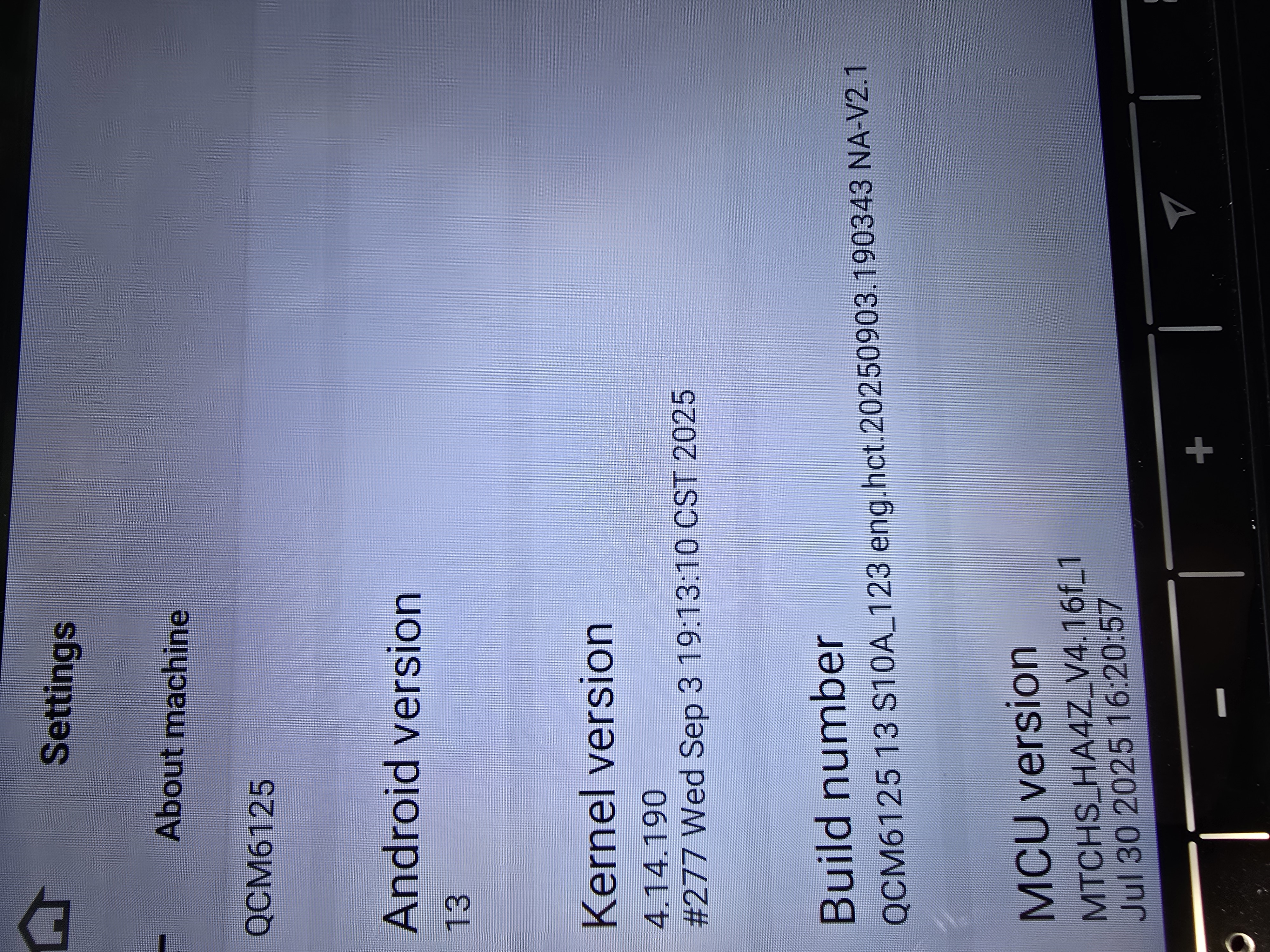

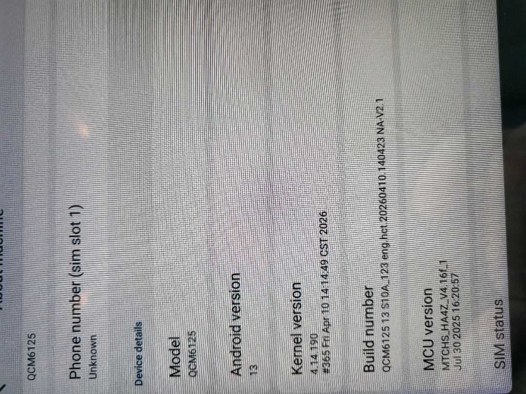

    I verified the Model number is QCM6125.
    Android version is 13.  Kernal 4.13.190.  Build number:  QCM6125 13 S10A_123 eng.hct20241022.090634 NA
    MCU version is: MTCHS_HA4Z_V4.15a_1   Nov 14 2024 15:38:58
    CANBUS is set to "08 TOYOTA_CAMRY&RAV4(Simple)"
