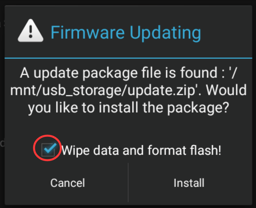

  • @Manuel Hermosillo
    Hello,
    Thank you for your reply.
    G13(20250311)
    https://www.dropbox.com/scl/fi/70whgvgq7f6fkkd42ncie/update.zip?rlkey=a036rb694v0nehdqh11omokvw&dl=0
    Format USB drive to FAT32 Format.
    Copy the file “update.zip” to the root directory of USB drive.
    Alternatively, please manually go "Settings > System > System updates" to start the update.
